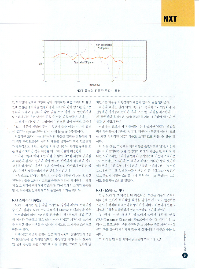

The sound produced by the Panel comes from the entire surface of the board – not just a central impluse, like that produced from a pistonic speaker. A much wider listening area and higher ambient level are just two of the advantages LoudPanels and Loudman have over traditional loudspeakers.

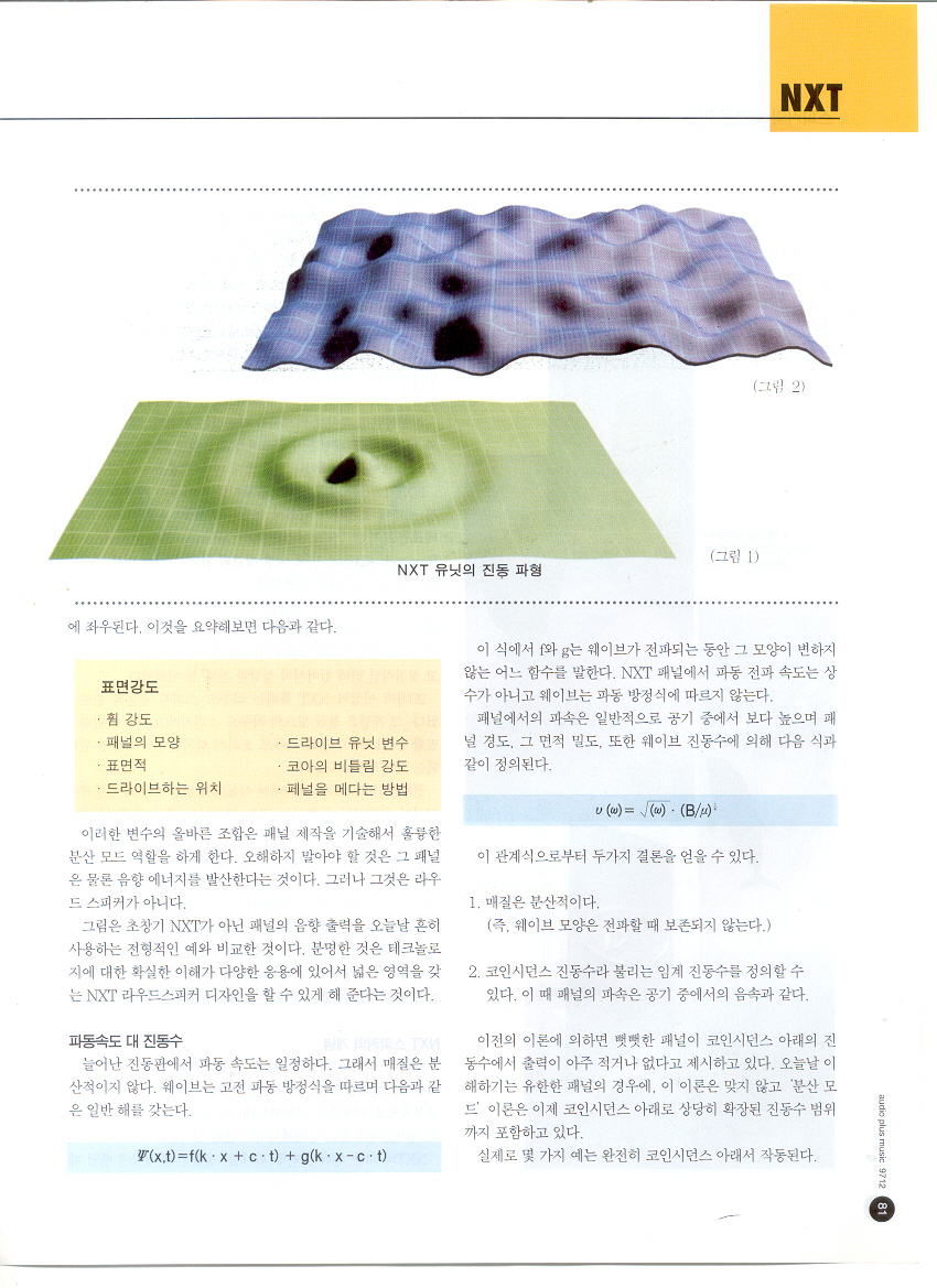

The exciters bonded to the surface of a specific designed laminate panel cause it to bend and flex. The board acts rather like a piano soundboard and amplifies the sound to normal listening levels. And the positioning of these exciters dictates exactly how the board responds to particular frequencies.
The NXT system provides a computer model that can predict the ideal location of exciters on a panel surface to produce a flat and extended frequency response. The way such panels work means it can provide consistent sound pressure levels over a wider listening area, because the sound is produced by longitudinal waves across the entire surface of the panel and a maximum excursion of only a few microns, the resulting audio waves are entirely different in nature.
