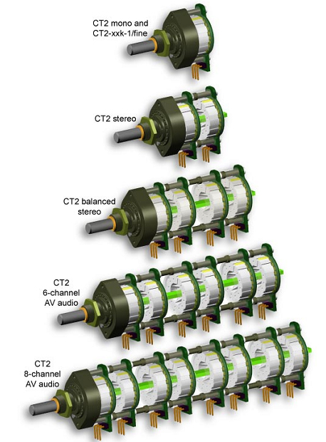

New from Danish Audio ConnecT (DACT) is their CT2-10k-1 ultra-fine 0.5dB
stepped attenuator. This is excellent for individual channel control in multi-channel systems, active crossovers, etc.
DACT's attenuators employ a resistor network using Surface Mount Device
(SMD) for ultra-short signal path plus verylow series inductance and stray capacitance. The CT2 series of audio volume controls are high quality stepped
24-position attenuators.
They are designed for maximum sonic quality, accuracy and reliability. This
makes them equally suited for audiophile applications and for professional applications. For many years DACT has been offering extremely high quality master
volume controls with 60dB attenuation range (1, 2, 4, 6, 8 decks).
Their series resistor networks consist of 23 non-inductive, low noise, SMD metal film resistors. The layout of the PC boards and the choice of SMD resistors
reduce the signal path to a minimum length (typical five times shorter than
conventional stepped attenuator designs with leaded resistors).
The PCB design combined with the special resistors also account for the very
low series inductance and the very low stray capacitance. The result is a bandwidth beyond even the most demanding audiophiles¡¯ requirements.
Special care taken to ensure the durability of CT2, therefore all contacts and PCB traces are gold plated to prevent any corrosion. Meanwhile the rotary
switch itself is a gold plated high precision switch manufactured in Switzerland.
Many high-end audio manufacturers and people in the DIY community enjoy
the benefits of using these stepped attenuators in their designs.
They are also used by those who tweak equipment to achieve higher quality music reproduction. High-end sound and specifications Compact design  easy
to mount in most existing audio amplifiers as DIY upgrade. Audio volume controls with very accurate attenuation and tracking (0.05dB).
Resistor network using Surface Mount Device (SMD) type of resistors for short signal path and very low series inductance and stray capacitance
Available as master volume control with 60dB attenuation range (1, 2, 4, 6, 8 decks) and as individual channel fine adjustment control with 0.5dB level
change between each step (only available with 1 deck).

The CT2 Audio Volume Controls are high quality stepped 24-position
attenuators. They were designed for maximum sonic quality, accuracy and
reliability. This makes them equally suited for audiophile applications and for
Available as master volume control with 60dB attenuation range (1, 2, 4, 6, 8 decks) and as individual channel fine adjustment (CT2-10k-1/fine) with 0.5dB
level change between each step (only available with 1 deck) Their series resistor networks consist of 23 non-inductive, low noise, SMD metal film resistors.
The layout of the PC Boards and the choice of SMD resistors have reduced
requirements.
There has been special care taken to ensure the durability of CT2. Therefore, all contacts and PCB traces are gold plated to prevent any corrosion. As a
result, the CT2s will maintain their specifications after long time of use even in hot and humid environments.
The rotary switch itself is a gold plated high precision switch manufactured in Switzerland.

Low noise, non-inductive, metal film SMD resistor network
CT2 PCB showing the SMD resistor network.
Compact design
Entire signal path gold plated
Shorter signal path than conventional attenuators with leaded resistors
Reduced inductance and stray capacitance
Improved sonic quality
Improved accuracy - 0.05dB tracking and 0.05dB attenuation accuracy
Improved reliability
Increased bandwidth
Reduced distortion, less than 0.0001%
